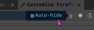

        Just to address the download arrow in Firefox 57 onward, if one wants the arrow to always be visible, click on Customize and then click on the download arrow. A little pop-up (?) appears to give the user the choice to autohide the download arrow.
        Kubuntu 20.04
          That works, but it doesn't do much. if you have no current downloads listed, it just says "No downloads for this session" and shows a link to the Downloads menu, which is already in the Tools drop down. So I just turned Autohide back on; the arrow will show up the next time I download something. Until then ...
