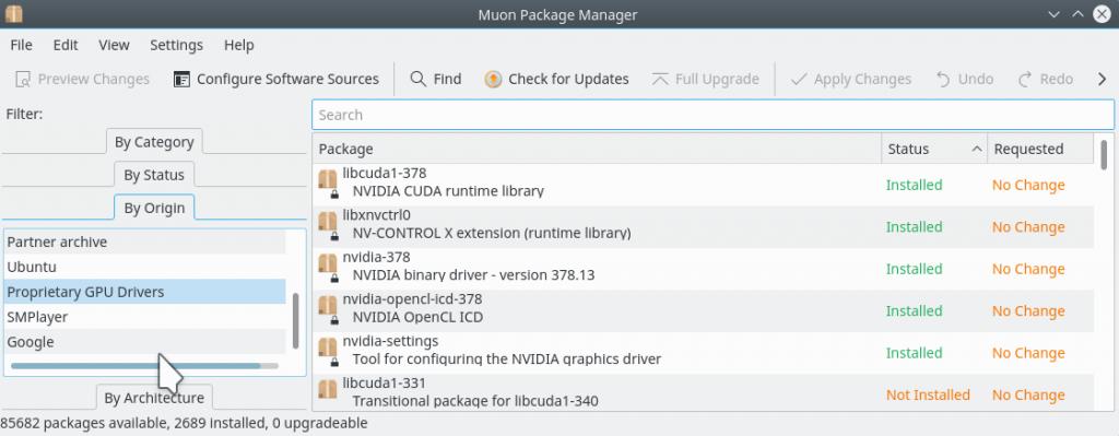

                I added the following repository to my /etc/apt/sources.list
                My Acer V3-771G has an NVidia GT 650M GPU and I use the nvidia 371 378 driver and its dependencies. I pinned all the packages so they could not be updated. (If it's not broke, don't fix it!)
                You can see the file names that are installed. My NVidia card, although it is a secondary card which CANNOT be made primary in the BIOS, behaves as if it is the primary and runs the Plasma desktop from the login and every app I run. Minecraft 1.12 vanilla gives me FPS ranging from 130 to 500.
                Purge your current installed nvidia, cuda and other GPU related packages, remove their entries in /etc/apt/sources.list. Add the ubuntu gpu repository and begin by usuing nvidia-378 and its dependencies. Reboot. If your nvidia isn't working try a more recent version, one step at a time, until it does.
                OR, reinstall 16.04 to get a clean base installation, then add the repository shown above, then (sudo apt-get update) and install the 378 package. Once you find the package that works pin it and its dependencies.

                          Did you delete manually, instead of using APT or a package manager? Normally, when you uninstall, remove or purge a package it will disable the systemd service.
                          Issue in a Konsole:
                          sudo systemctl disable nvidia-persistenced.service
                          sudo systemctl masked nvidia-persistenced.service
                          Then, clean your repository archive:
                          sudo apt autoclean
                          The archive will be rebuilt the next time you use apt or apt-get.
                          I'd recommend using Discover, Muon or Synaptic to add or remove packages from the repositories until such time as you feel proficient in doing such tasks manually as root. Merely deleting directories a/o executable binaries is a method guaranteed to corrupt your system and your local archive, even if you installed them manually yourself. Under the "Origin" catagory in those package managers will be the list of packages you installed using Qapt in Dolphin, or dpkg from a CLI. You can delete them using the package manager.
                          Considering all the time you've used so far it would have been easier and much quicker to just re-install using a LiveUSB.
