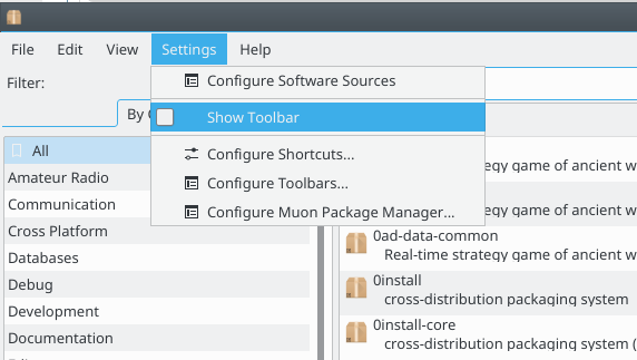

    Just go into Settings > Show Toolbar

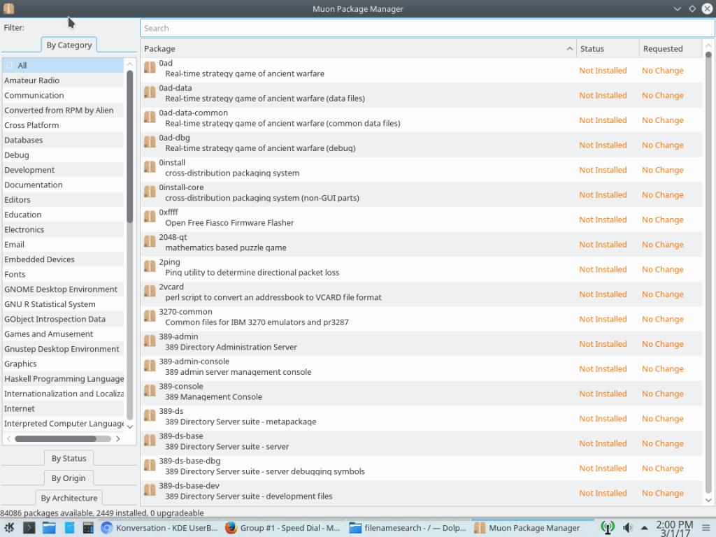

      That is the problem...I don't have that top banner of choices. At the top is the filter on the left and search bar on the right and that is it ... nothing above it. I have no idea how to get the banner that shows File / Edit / Settings / Help.

          I've included a pic of what I see.Click image for larger version

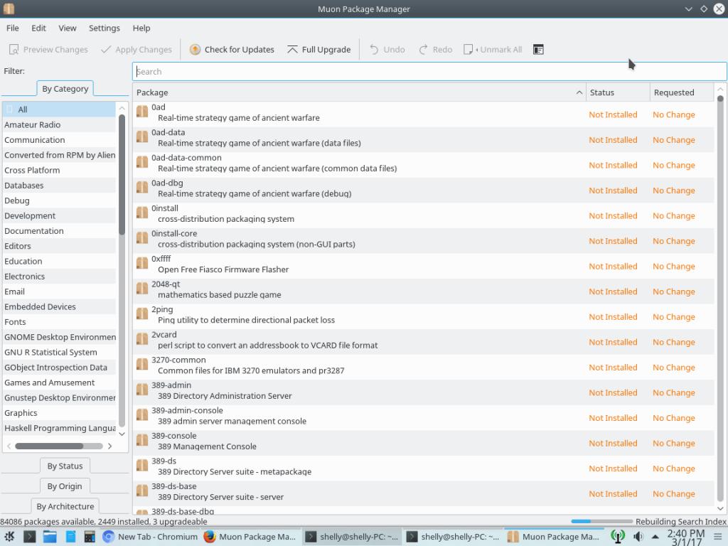

                  Thank you. Even though I got an error message on part of that second command, upon re-install I find that the missing menus are back.
