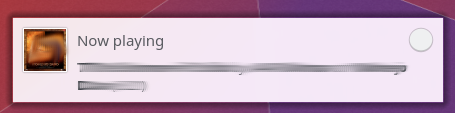

    This has been bugging me for a little while... ever since I have upgraded from 15.10 to 16.04, the close icon at the top right corner of all notification bubbles is not visible. I just see an empty circle (see attached screenshot). It doesn't have an X inside it. Presumably it is not meant to be empty, right? What does it look like? How can I bring it back?

                Plasma close button
                The plasma close button is part of the plasma theme: https://techbase.kde.org/Development...5/ThemeDetails
                /configuration-icons: it's a set of simple icons that are meant to be shortcuts for configuration actions (KDE 4.2 and later). Must contain the following elements:
                close: a close icon
                If the plasma theme doesn't have the 'close' icon then the plasma will try to use the icon theme 'windows-close' icon:
                If the icon theme doesn't have the 'windows-close' icon the plasma will show the bare button:
                Something to try.
                1) Clear the plasma cache and the icon cache (icon-cache.kcache).
                2) Try another plasma desktop theme.
                KF5 cache files are at: https://specifications.freedesktop.o...ec-latest.html
                $XDG_CACHE_HOME defines the base directory relative to which user specific non-essential data files should be stored. If $XDG_CACHE_HOME is either not set or empty, a default equal to $HOME/.cache should be used.
                Cleaning the plasma cache:
                1) Open a flile manager to the cache directory
                2) Shut the plasmashell down:
                kquitapp5 plasmashell
                3) Remove plasma* files and icon-cache.kcache from the cache directory
                4) Restart the plasmashell (Krunner):
                plasmashell
