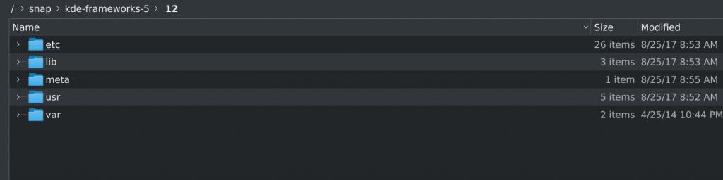

                              So my system got borked today, not really sure what happened. I reinstalled Neon Users Edition, while maintaining my home folder so all in all it was fairly simple (took about 30-45 minutes) and most things are working as they were before. BUT, the symbolic links I made didn't carry over. I made the links again, as Vinny described above but they don't survive a reboot. ?
                              Also, and I have no idea if these are related but I now have a Loop Device in my device list, see below:
