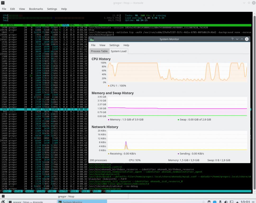

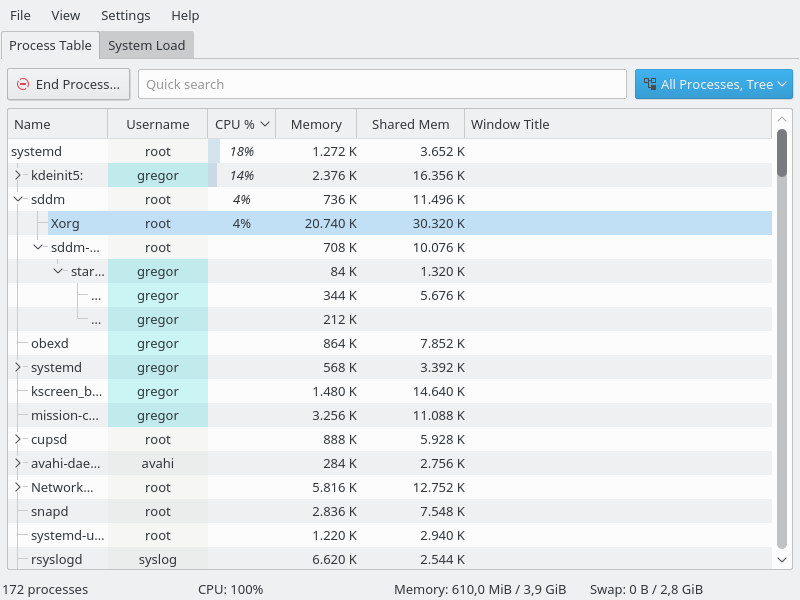

    all this time system monitor showed CPU at 100% and everything lagged a lot. but top didn't show any major increase. also the system monitor itself accounted only about 30% of CPU use.
    this was also the case after installing everything. the menus and such seem responsive, but once an app is loaded (e.g. Firefox, Kate) everything is slowed down a lot. i can't find what is causing the slow down. OK for the app to load slow the USB is at fault, but after that there is plenty of RAM being available... how could i find the process responsible for taking so much CPU?
    here are the readings when CPU was used 100%

    Top showed similar usage.
    The CPU is used 6-10% or less (2-3 %) when on idle. probably something that is expected.

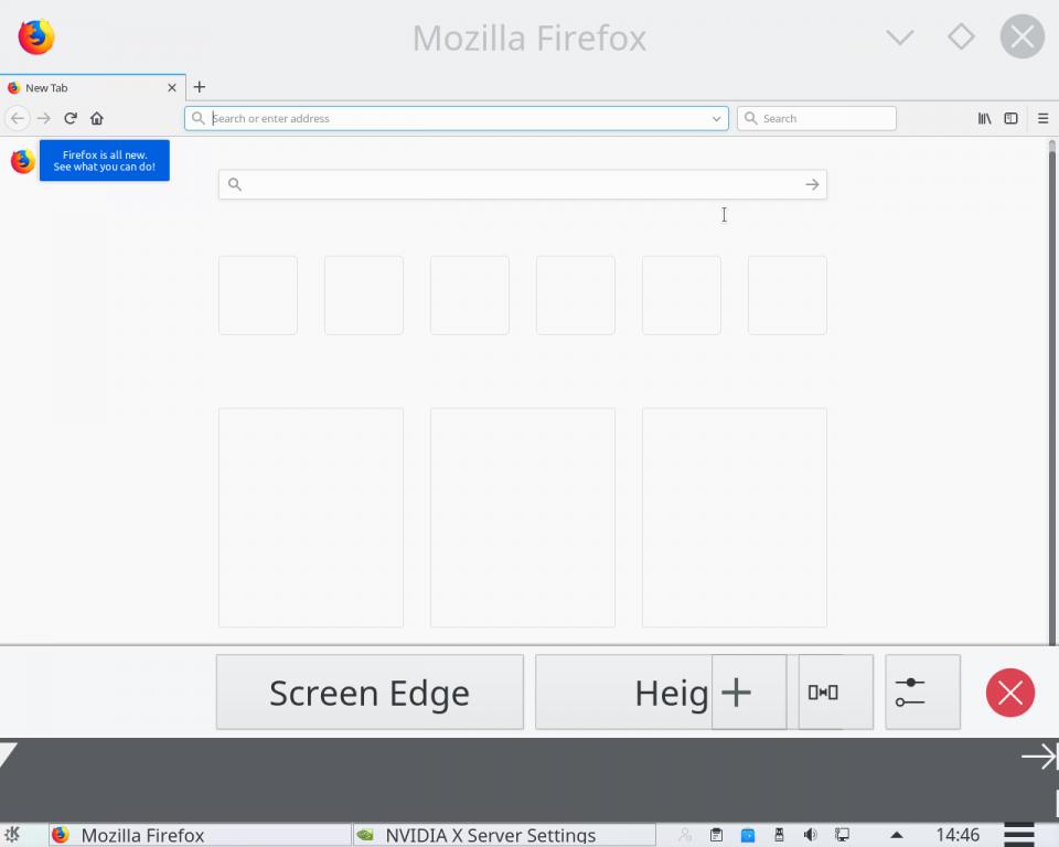

    Another issue was that after installing nvidia drivers all fonts were huge, while the LCD monitor was recognised as CRT. i guess others have faced that and this is solvable.

              that's what i was thinking about yesterday as well. i remember it was an issue in the older machine, so i left it overnight to do it's job. but the old search indexing showed up in the system resources usage.
              if you look at my screen you can see 100% CPU taken, but when you see the upper parts where processes are sorted by CPU usage it should be more like 30 or 40 % used. similar picture is showing in top. i will try with htop or gkrelm to see if they show any difference.

                    so i managed to install htop, but same thing. nothing is shown to be taking up too much CPU.
                    one thing that bothered me is that when i was trying to install htop, it kept saying the folder is locked. so i payed close attention to top at the time and saw that unnatended- upgrades is popping up and down the table. it looks like they locked the drive. i waited for them to finish whatever they were doing, to be able to install htop, i then set the compositor to use OpenGL 3, turned off baloo, but there was no change.
                    so i did a reboot and after that system usage was fine, everything was very responsive (well loading of apps took a bit longer, because it is from USB), but once they loaded all was responsive. also the CPU usage was very low (within what could be expected)
                    i then also noticed that despite running the upgrades the system still had plenty of upgrades to do. all in all it seems the slowness of the OS and high CPU usage was from unfinished updates. maybe the compositor switch to OpenGL3 also helped (eventhough it hsouldn't matter since live session works well). i was also unaware that unnatended-upgrades were enabled by default. as i know in 14.04 you had to manually enable them.
                    Htop along with Ksysguard. Htop showing usage of 11%CPU, while guard's usage is showing it near the top. It also acts as if full CPU was used. Though again if one looks at the processes there is nothing there that would have such high CPU usage.
