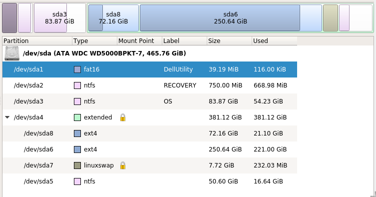

    Dear all,
    after I installed with much difficulties Kolourpaint and thanks to your help (https://www.kubuntuforums.net/showth...ht=kolourpaint), I can no longer boot my computer.
    After I choosed Ubuntu (which represents Kubuntu 16.04) Click image for larger version
ID:	649236in the GRUB, there is the presentation of the Kubuntu 16.04 system and then it's black with the cursor that I can move and all my Knotes post-its.
    I tried to boot with the generic and the recovery mode with the selection of fdsk and pkg, but it doesn't change anything.
    Now I want to install Kubuntu 16.04 from a live USB again (I mean that I intend to repair the hard disk). But I*don't know where in the partition (for me the partition is all the parts of it i.e. Kubuntu 16.04, Kubuntu 14.04 and Windows 10) Kubuntu 16.04 is installed. I write you how the parts of the partition appear in the GRUB and I*send you a picture of the partition:

    As I first installed Windows, then Kubuntu 14.04 and finallly Kubuntu 16.04, are we able to determine where Kubuntu 16.04 is installed please?
    After having written you this, I*guess it is the sda8. Thank you very much for being in the forum.

    Why do you have sda4 and linuxswap locked locked (readonly)?
      Thanks for your answer GreyGeek,
      I have no idea, why sda4 and linuxswap are locked. I think that I*should unlock linuxswap if I want to delete sda5 in order to move sda6 and sda7 to the right to increase the size of sda8.
      But first, I have to repair sda8.
        Why do you think sda8 is broken?
          By design, any partition in use is locked to partitionmanager to prevent inadvertent file system. SDA7 is your swap partition. To "unlock" it, turn swap off.
          sudo swapoff --all
          SDA4 is an Extended partition. If any of the Logical partitions within it are locked, naturally so is the Extended partition. This wouldn't effect your ability to resize SDA6 anyway.
          Don't waste time "moving" a swap partition, just delete it and re-make it when you're done resizing SDA6. Don't forget to edit /etc/fstab to reflect the change in UUID (or replace the UUID with correct device name instead, like /dev/sda7).
          To GreyGeek's point: You don't really say anything about why you're doing all this. SDA8 is already 78GB - 4 times larger than the space you've used on it to this point. I've never seen a Linux install taking more than 20-22GB. Moving partitions with data on them is dangerous. Why risk losing everything to add 10GB or whatever to a partition already too large for what it's being used for?
          Just because you're booting to a black screen doesn't automatically mean your file system is damaged nor does it guarantee a re-install will fix it. You may be putting the cart before the horse.
            In answer to another of your questions, the way to tell what is residing on any particular partition, in this case SDA8, is to mount it a view the data.

                    Thank you GreyGeek for your question. I think that I remember that I installed Kubuntu 16.04 at the left of Kubuntu 14.04, because:
                    - I could grant it more space than at the right of Kubuntu 14.04, as I took space from Windows (if my memory is good)
                    - the computer strongly advised me to put this new system there (my memories come back slowly).
                    Do you mean that a black screen doesn't mean that sda8 is broken?
                    Thank you oshunluvr for your exhaustive answer! You wrote "Just because you're booting to a black screen doesn't automatically mean your file system is damaged nor does it guarantee a re-install will fix it. You may be putting the cart before the horse.". It seems you think like GreyGeek. Please what should I*do in order to fix this black screen?
