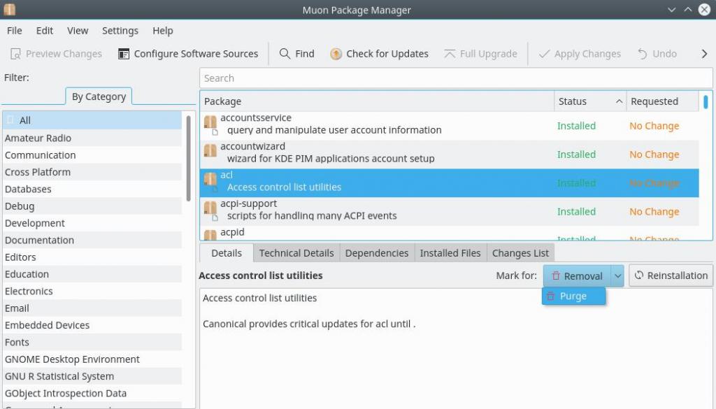

      When you click on Removal, you are presented with other options.
        Steve7233
        What Snowhog said, and, I'm using version 5.7.0

          steve7233@
          Nope not in this version.
            Where did you get your version? I used discover and it downloaded version 5.6.0.
              #21
              I'm running a fully updated KDE Neon User Edition and Muon is at version 5.7.0
                #22
                Version 5.6.0 on my system includes a Purge option if you click on the down arrow next to the Removal button.
