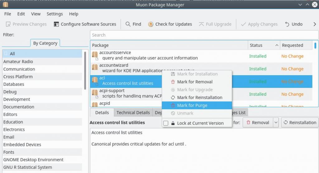

                              EDIT: Nevermind, I used KDE info center and used muon to remove the other one. Actually the proper word is purge but Muon calls it remove even though it really purges the kernel.
                              My Muon offers purge:
