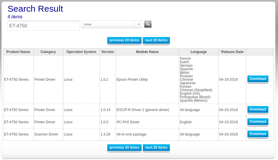

So, I turned to Epson to find their Linux scanner driver package:
I started here:
Can confirm that the "all-in-one package" says it supports the ET-4750. I ignored the printer drivers and downloaded the 16.04/32-bit scanner driver package:

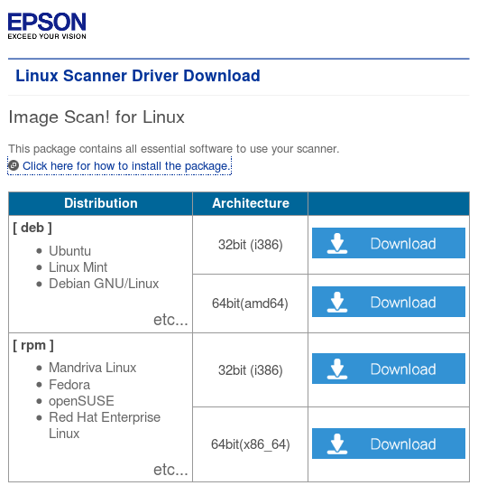

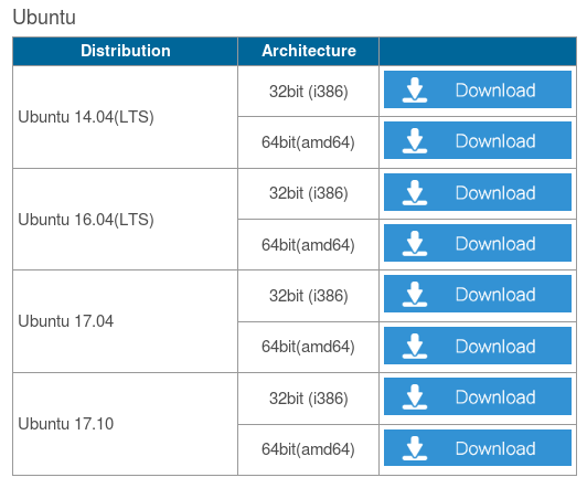

Thinking I might have made a misstep along the way, I wiped the slate clean and started over. I sent the downloaded packages to trash, and returned to Epson to get the driver. For reasons I can't explain but may be related to the fact that I did a fresh -- and thus possibly slightly different -- web search, I found myself at a different front door at Epson:
I downloaded the Ubuntu 32-bit package. I'm not quite sure what to make of the "(i386)" designation on that package, as my architecture is i686; but I don't know if that's relevant.
