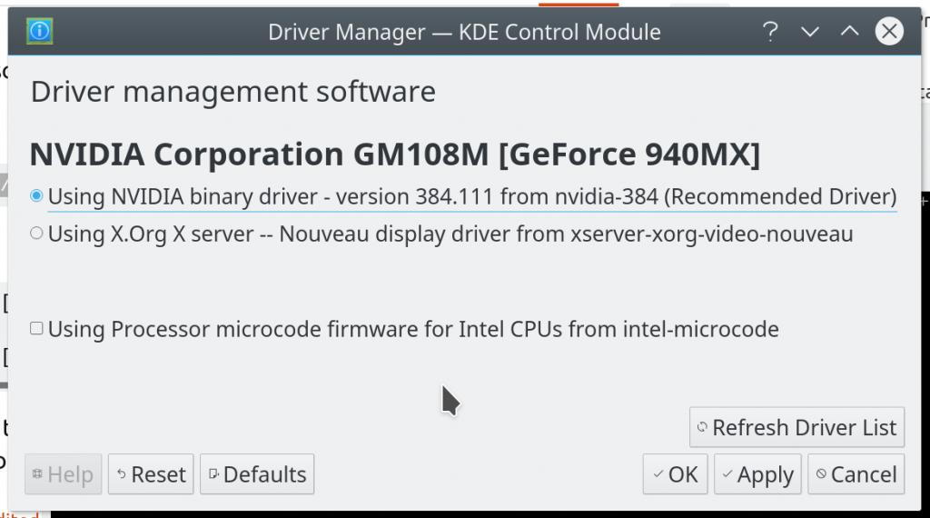

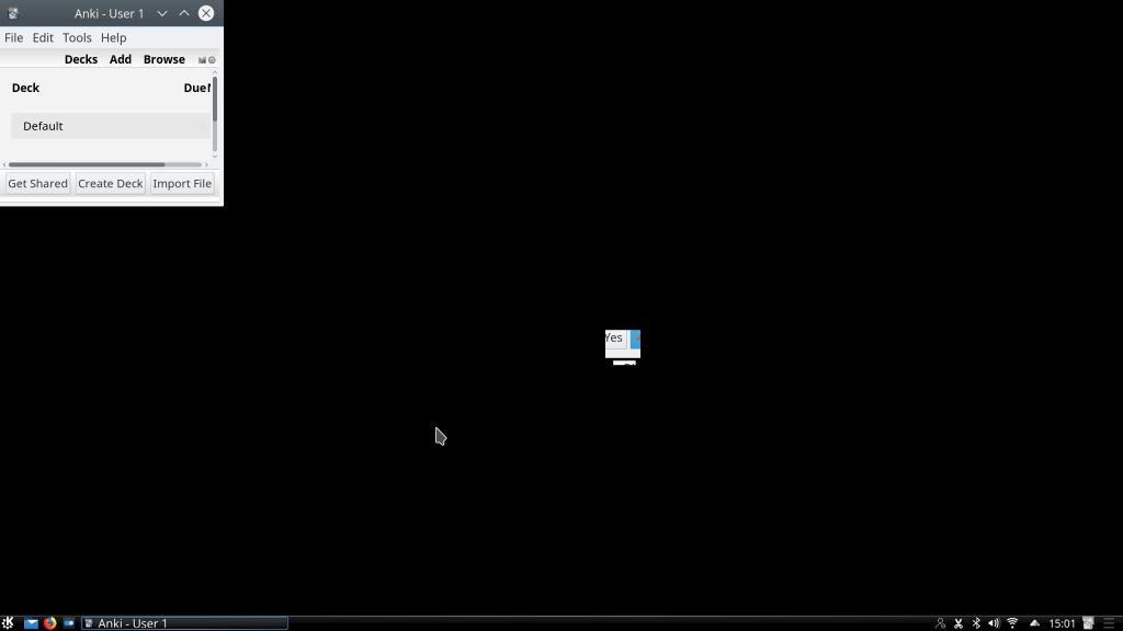

    My question is the following: on my computer I have two graphic cards. An Intel and an NVidia. When I activate the NVidia one with NVidia X Server Setting, I start observing some little white cube appearing and disappearing near the pointer of my mouse sometimes the cube is filled by something which is on the screen (or was). This problem doesn't occur when I use the Intel card. I recently reinstalled kubuntu and I have this problem only since then. I don't remember which driver I was using at the time, but I think that I am currently using the ``recommended one" since it is what the driver manager recommends me:
    I can live with this even if it is a bit annoying, but I would like to know it the performance of my graphic card are also affected, in term of computation time.
    I put here a print screen where you can see by yourself (note that in this case the pointer was a bit further away from this cube):
    These cubes disappear when I move the pointer, but they are a bit annoying and I'm afraid that it may indicate that my NVidia card is not working properly.

      Thanks a lot for doing this. Now I understand better how this all work.
      In between I found the a workaround to my problem here:
      https://bugs.launchpad.net/ubuntu/+s...4/+bug/1684240
      which is:
      ``My workaroud for this Problem: Go to KDE System Settings -> Display and Monitor -> Compositor (left side) -> set "Rendering Backend" to XRender"
      Have a nice day.
        I saw several reports of this varying with driver versions and Xorg versions. As you get more comfortable with Linux, you might consider attempting a driver change to see if things improve. On the other hand, if your setup is working to your liking, no need to change anything.
          Thing is, I don't know exactly what to choose. Some people in the link that I mentioned above said that using Nouveau driver instead of the NVidia ones were solving this specific problem.
          But for me it is quite important that the GPU works properly, and I have no idea how these drivers affect (or don't affect) the performances of the graphical card. Do you know if there is a way to measure if a card is working properly or not, in term of performance? I need to do some computation for some image recognition tasks (neural networks/deep learning), and a good GPU is really required.
          For now as I don't see any obvious problem anymore, I will stick with my configuration since it's working.
