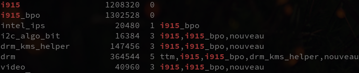

      Thanks, here is the output of lsmod:
      The video driver IS i915 by the looks of it - just like yours. Does it list the drivers in order of preference or something? I'm not sure how to interpret the rest of the stuff on that line. Or, indeed, the rest of the stuff mentioning i915 in the lsmod output.
      Do you think the difference in the lspci output between the laptop that works and the one that doesn't is significant at all?

        lspci lists specific hardware IDs present, drivers are irrelevant to it.
        The differences in the lspci output between two different machines is because they contain different hardware.
        The listing of lsmod does not matter, really. We are just looking to see if the video driver is loaded.
        The problem with sleep and screen brightness is a power management problem as opposed to a video driver one, I think.
