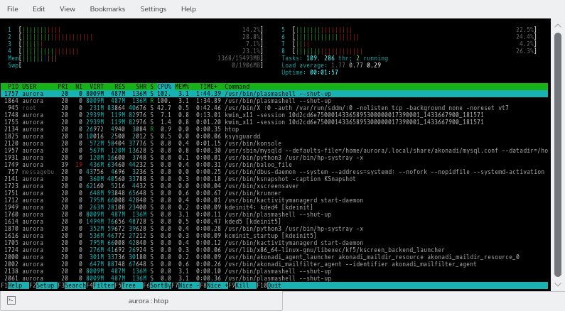

    I am having trouble with not being able to use Vivid with the desktop becoming frozen as well as the clock. This has lasted for over 20 minutes, until I consider it has more time than necessary to sort itself out, so I use the power button to close the system down.
    I have attached a graphic showing what htop output gives after reboot:
    If, for example, I try to exit Thunderbird, it is not removed from the taskbar. From the htop output, it appears to me that it is in a loop, which becomes worse when launching applications that lead to the desktop becoming frozen and unusable.
    Has anyone else encountered this problem?
    You have multiple instances of several programs running, which is certainly unusual. In System Settings -> Startup and Shutdown -> Desktop Session, which item is selected in the On Login section? If it's one of the two Restore... options, change it to Start with an empty session. OK your way out and then restart. Does the problem go away?

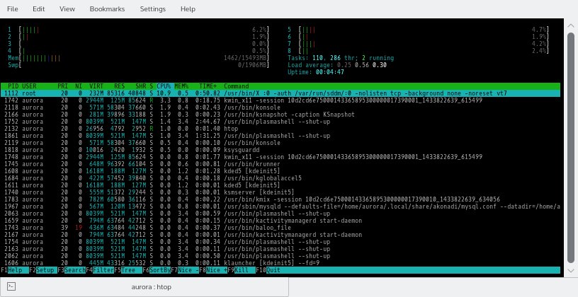

          It Has Come Back
          I thought that the problem had been fixed. I tried launching several applications and the system behaved itself. However, during a Skype session, it returned. It doesn't lock up the desktop, but plasmashell once again is doing a lot of knitting, as shown below.
          It seems as though Skype and Plasma5 have an incompatibility problem that needs to be dealt with.
              Something super weird is going on here. Look at how many instances of things you have:
              • 5 plasmashell
              • 2 kwin_x11
              • 2 kactivitymanagerd
              • 2 hp-systray
              In your previous screenshot:
              • 3 plasmashell
              • 2 kwin_x11
              • 2 konsole <-- could be normal if you have more than one console window open
              • 3 mysqld
              • 2 zeitgeist-datahub
              I suspect that one instance of Plasma Shell zooming to 100% CPU utilization is just a symptom of some more significant underlying configuration problem. Furthermore, I'm not convinced that Skype is the cause of that. Something on your machine is causing multiple instances of several programs to start, and the computer doesn't know how to handle this properly.
                • 5 plasmashell
                • 2 kwin_x11
                • 2 hp-systray
                • I am puzzled by the numbers 5, 2, 2, 2 that you have listed and would like to know what they mean. From the htop display plasmshell processing state is S with 102% processing. The next instance of plasmashell has a processing state R ie running with 100% processing. Both X and 2 of kwin_X11 are suspended.
                My understanding from here is that plasmashell provides the workspace for kwin and X. It is therefore involved in the running of applications. In the case of Skype, it is 32B and uses X. I therefore would think that its involvement could cause the problems I am experiencing.
                I would say that it is the operating system that causes this as I have in the past witnessed multiple instances of processes.
                  I've learned something here.
                  I've not spent any time with htop and obviously didn't understand how it worked until just now. After watching it operate for a few minutes, I'm seeing the same thing -- multiple suspended instances of several processes, including plasmashell. Pressing F6 and sorting by "Command" is illuminating. I currently have 44 instances of this, all suspended. They have different, sometimes consecutive, PIDs. One has been running for 18 hours 25 minutes, another for 4 hours 15 minutes. The remaining have executed for less than 1 second.
                  Here's my confusion, so far -- the output of ps shows only one plasmashell. Its PID matches that of the longest-running instance in htop. But in htop, even this process shows suspended most of the time. Only occasionally does it switch to running.
                  Now then, pressing F5 rearranges the output in a tree format. The main plasmashell (with the same PID as in ps) has spawned all these others at some point in time. Ah hah! Pressing H, to hide user threads, reveals that all these plasmashell suspended processes are threads that belong to the main process.
                  Confusion cleared! Unlike top which defaults to displaying tasks, htop defaults to displaying threads. Furthermore, htop remembers your display settings.
                  So please excuse my ramblings here. I was chasing an incorrect idea.

                        FOUND the CULPRIT
                        After creating a new desktop and configuring it to my liking, I found that the CPU usage was back to plasmashell hogging resources.
                        So I was wrong in blaming Skype for creating the problem as I only became aware of the problem during a Skype session.
                        So I have just finished a witch hunt for the culprit and it is the widget Network Monitor. When it is present the htop output is:
                        When I remove Network Monitor the output is:
                        Removing widgets, freezes the desktop and can take over a minute for the notification to finally go. I do like to monitor the network and I much prefer the one in Utopic which gives a noticeably different colour for sending and receiving.
                        I would be very interested to know if others experience this problem with Network Monitor as it will confirm that this is the culprit.
                          https://bugs.kde.org/show_bug.cgi?id=345696
                          and this (probably a dupe)
                          https://bugs.kde.org/show_bug.cgi?id=348764
                            Thanks very much for that. It looks as though I am a bit slow off the mark but at least it is a confirmed bug and something will be done about it.
