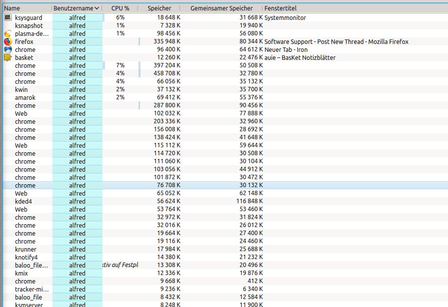

    You can also find enclosed a picture of the CPU use.

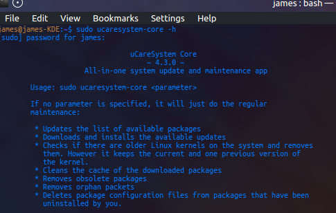

            Another great tool used by some around here is ucaresystem-core. You can read more about it here. In essence, it's a simple script file that performs a series of maintenance-type tasks, as outlined in the accompanying screenshot. I've used it on all installs since I found out about it and can't really recommend it enough. Additionally, myself and others here have perused the script and can attest to it's simplicity and thoroughness.
