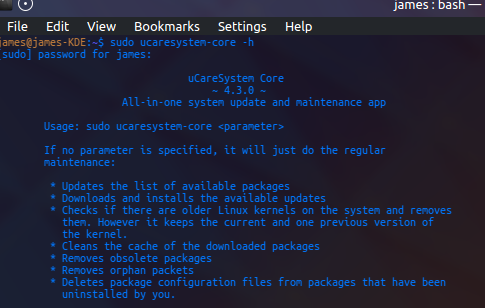

      Or again, you could install and use ucaresystem-core, which does the above and more
        And I have this script 'installed' and use it as well.
          It doesn't seem to install correctly for my Neon/Kubuntu configuration.
            OK so I have seen you push this before ,,,,,and just took a look at the page linked to .
            you seem to use it so I will ask you ,,,,,,,dose it run "apt upgrade" or "apt full-upgrade" or can you tell it witch to use?
              in what way do you mean ?
              @hear if I download the ucaresystem-core_4.3.0_all.deb for xenial and rite click it >open with>QApt package installer ,,,it tells me it needs 18 additional packages (mostly gnome and GTK stuff that would be ok) ,,,,,,,I have not done it yet .
                apt full-upgrade
                    I did all that, and it seems to work, yet I get error messages in the process, even though it says it's done. I can't copy/paste the output, but one message is that it can't find a neon/xenial template; another is that errors were found while processing ucare-core, without specifying what those erros were. I can do all this maintenance stuff the way I used to, but ucare-core seems a nice way to do it all quickly.
                      apt full-upgrade
                      humm the page linked to said "apt upgrade" ,,,,the deborphan thing is all that makes me apprehensive for trying it .
                        yes and it wont ,,,,,their is a way to change how it would read this as ubuntu and be ok ...but this is one more thing that makes me apprehensive for trying it on a non-standard system like ours .
                        I think I will stick with running my own package maintenance tasks.
                          Not sure what you mean here, as I only run KDE Neon on multiple systems and have never seen such messages in the years I've run it...It's made for any debian-based distro; Ubu, Kubu, Mint, Neon, should make no difference. The source code is here - feel free to peruse it. The relevant section is

                          But really, whatever works for one, by all means, is what should be used. I really am not here to "push" it any more than saying I use "xxx" browser. Take it for what it's worth, I merely wish to inform.
                          K*Digest Blog
                          K*Digest on Twitter
                            I believe that is actually true, and if I wasn’t able to change that, I wouldn’t use it. I edited the script and replaced “apt upgrade” with apt-full-upgrade”. Running “apt upgrade” is a sure way (IMO) to wreck havoc on your system!
