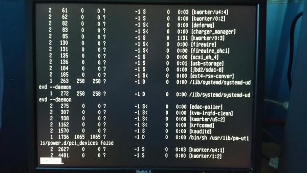

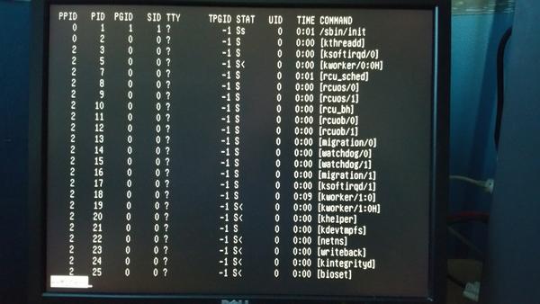

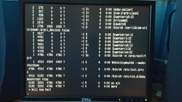

    OK, here are the screenshots of what went flashing by. lsof | more did the trick. It doesn't look like ps ran.
    Sorry they are out of order. I thought I uploaded them in order.
    To my untrained eye, it looks like everything shut off except for a few at the bottom that are system services, and I don't see network manager in there anywhere.
    Let me know where to go from here.
    Frank.
      Actually, it looks more like lsof did not run. I just checked outputs of both of those commands on my running machine, and the pictures above look more like ps ajx.
      Frank.
        Yeah, nothing useful there that I can see. Ok, lets try this; We're going to see what processes are running before the umountroot script is called.

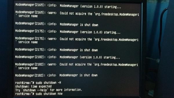

                      oshunluvr:
                      Curiouser and curioser, as the expression goes....

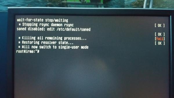

                      Did as you said, and succeeded in logging into text mode. I didn't know how to do that before. It will now go into my troubleshooting notes for future reference.
                      [COLOR=#3E3E3E][FONT=sans-serif]sudo service sddm stop[/FONT][/COLOR]
                      Ran that. Unrecognized service was the report I got. So I continued with
                      [COLOR=#3E3E3E][FONT=sans-serif]sudo telinit 1[/FONT][/COLOR]
                      and got the output as per picture 1.
                      Then tried the next command
                      [COLOR=#3E3E3E][FONT=sans-serif]sudo shutdown -H[/FONT][/COLOR]
                      And got the output that it was expecting a time rather than -H

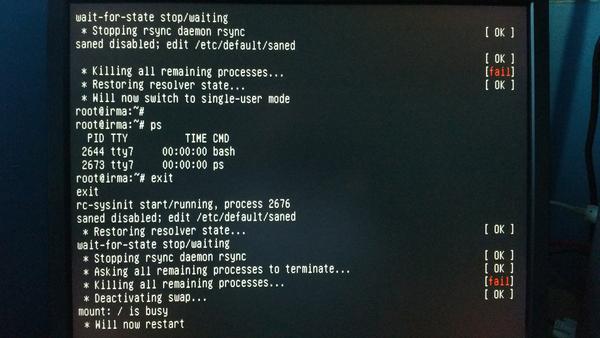

                      I then did sudo shutdown now, and got the output in picture 2

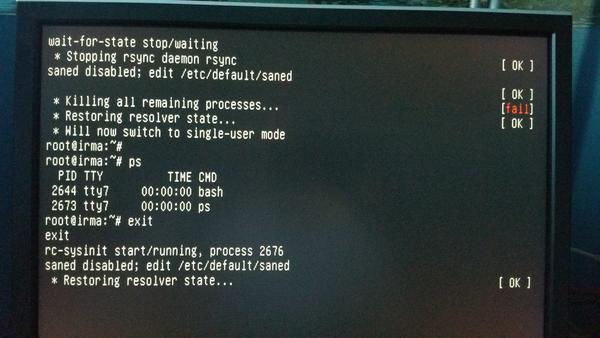

                      It stopped there, but did not shut down. As the command line was still active, I tried the ps command. Then tried:
                      sudo exit
                      as in picture 3. And, at that point, it locked. I tried several things, finally giving it the 3 finger salute Ctrl-Alt-delete, and got the output in picture 4, which is back to where I was before.
                      Now, I quite likely, in my ham-fistedness, did some things there that undid what you wanted. So, if you are still willing to put up with me, I'm ready to learn more.
                      Frank.

                        Yeah, it should have been:
                        sudo shutdown -H now
                        sorry, -H means "halt"
                        Seems like it will shutdown. I sure wish we could figure out what is holding up the remount. No ideas at the moment...

                          I also tried:
                          [COLOR=#3E3E3E][FONT=sans-serif]sudo service lightdm stop[/FONT][/COLOR]
                          As there appears to be no sddm running on this machine. I got a list of running services using
                          service --status-all
                          and sddm is not listed, but lightdm was. However, it made no real difference.
                          I also updated the machine this morning hoping the new kernel update would magically fix things. Nope.
                          I'm updating the nVidia video driver now as a shot in the dark.
                          Why does modemManager keep restarting? Is this thing respawning and leaving something open?
                          Frank.
