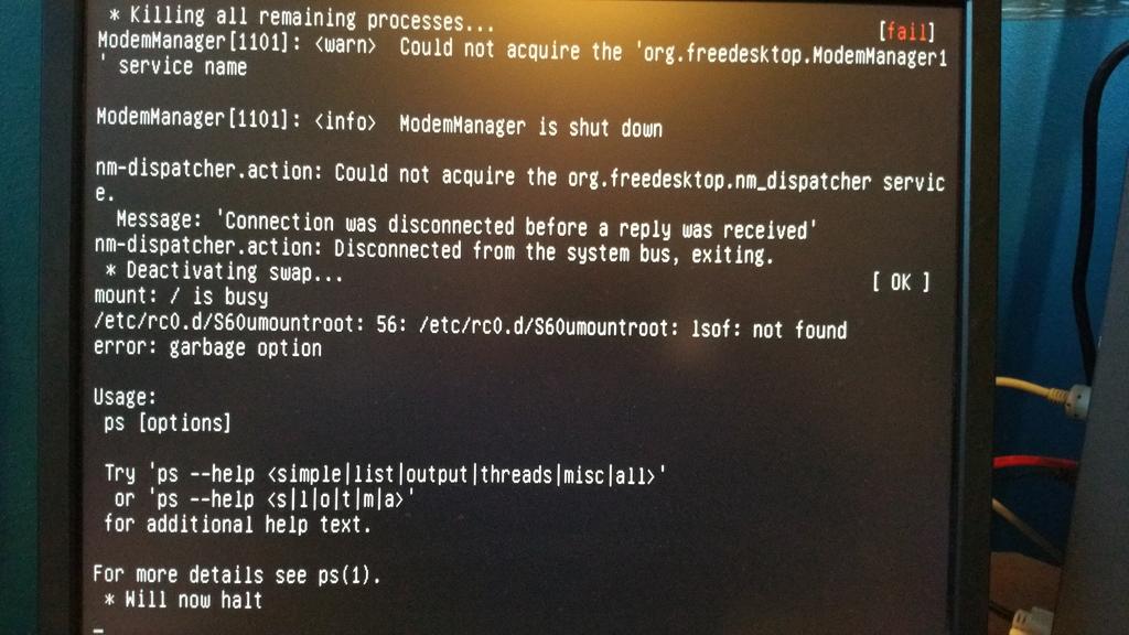

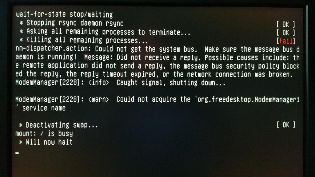

    It seems this problem is back again:
    https://www.kubuntuforums.net/showth...ght=mount+busy
    I'm about ready to pull my hair....
    The more I try, it seems the worse it gets. Please see screenshot.

    This did not appear to do anything on the first machine, the screenshot of which I have attached.
    It worked once on the second machine (more about that later), but now that second one won't boot at all. It stops midway with a kdm panic of some description.
    I can only get these machines to shut off if I press and hold the power button, and that messes up the system drive. Restarting normally then gives a kernel panic. Restarting again in safe mode, and running fsck, then continuing the boot brings it back up again, but the next shutdown is the same thing all over again.
    The first machine has a brand-new fresh install of 14.04 with the latest updates all installed. Boot disk is a brand new Samsung 850 SSD. It has a second mechanical hdd, but I have not been able to get to the point of using it yet, as I can't resolve the shutdown issue.
    I would chalk this up to a specific issue with this machine if my second desktop machine were not displaying similar problems. It too now hangs on shutdown, with similar error messages. It is a mature install from two years ago, and it too was recently updated to the latest software available. Trying to boot into safe mode on that second machine and running fsck never seems to terminate, and rebooting again just gives the kernel panic. I can't get it going again at all. Please see second screenshot.
    I tried booting a previous kernel on both machines, but no change on exit.
    Both machines are running Kubuntu 14:04 with 3.13.0-83-generic, and are both 64 bit machines with 64 bit kernels.
    I am down to my laptop now, and, for the time being, I will NOT update it.
    At this point, at least the one machine works if I run fsck in recovery mode. As noted, the second one seems to be hung in fsck at the moment. I could probably drop to a command shell and try running fsck that way, but I will need some help with that.
    Any help or suggestions appreciated.

    Could be a process still has an open file and is preventing umountroot from remounting the root filesystem as read-only (this is part of the shutdown process). I see a couple Network Manager messages there on your screen shot. It could be the culprit. Just for fun, boot up that system and kill network manager completely then try shutting down. If that doesn't work, maybe adding this to the umountroot script will give some useful output:
    ps ajx or maybe lsof
    As always, have a liveUSB bootable handy before doing any system edits.

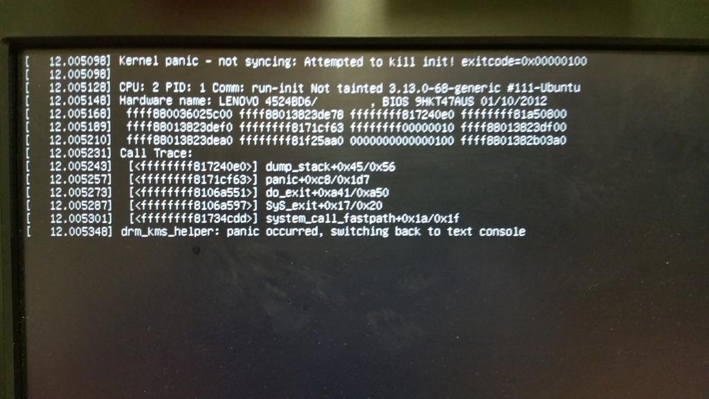

    The other screenie shows a kernel panic (not KDM panic?). Is that what you meant? We haven't used KDM by default in quite awhile.
      oshunluvr,
      I thought I had edited that KDM comment. Sorry. It is indeed a kernel panic, and I knew that when I posted. Just missed editing it out, I guess.

                    Its two commands, so try
                    lsof
                    ps ajx
                      OK, just got back to sleuthing this issue.
                      I edited /etc/init.d/umountroot to look as follows:
                      MOUNT_FORCE_OPT=
                          [ "$(uname -s)" = "GNU/kFreeBSD" ] && MOUNT_FORCE_OPT=-f
                          # This:
                          #     mount -n -o remount,ro /
                          # will act on a bind mount of / if there is one.
                          # See #339023 and the comment in checkroot.sh
                          mount    $MOUNT_FORCE_OPT -n -o remount,ro -t dummytype dummydev / 2>/dev/null \
                          || mount $MOUNT_FORCE_OPT -n -o remount,ro              dummydev / 2>/dev/null \
                          || mount $MOUNT_FORCE_OPT -n -o remount,ro                       /
                          lsof       >  /home/irma/lsof.txt
                          ps ajx    >  /home/irma/ps.txt
                          ES=$?
                          [ "$VERBOSE" = no ] || log_action_end_msg $ES
                      As you can see, I played with the commands in an effort to pipe the output to a text file that I could read later, as otherwise the output goes by on the screen too quickly to read. Anyway, the system did not like my little effort, calling my command a 'garbage option'! (snif). The output I got is on the attached screenshot.
                      Suggestions? Corrections?
                      Thanks.
                      Frank.

                        Did the pipe fail because the machine is mostly shut down? It worked on my own machine when I tried it from a console. Should I try
                        lsof | more
                        Frank.
                          Can't hurt. Likely cant redirect to a file this late in the shutdown.
                          You could remove the redirect, record the scrolling text with your phone, play it back in slo-mo
                            Hadn't thought of taking a video. Though I think I'll try lsof | more first, and take pictures one screen at a time.
                            Once I have the output, what am I looking for?
                            Frank.
                              Some process has a file open. You want to know what processes are running that have open files. I'm still wagering it's network manager. You should really try and kill it and all network processes then shutting down manually to see if it breezes past the remount.
