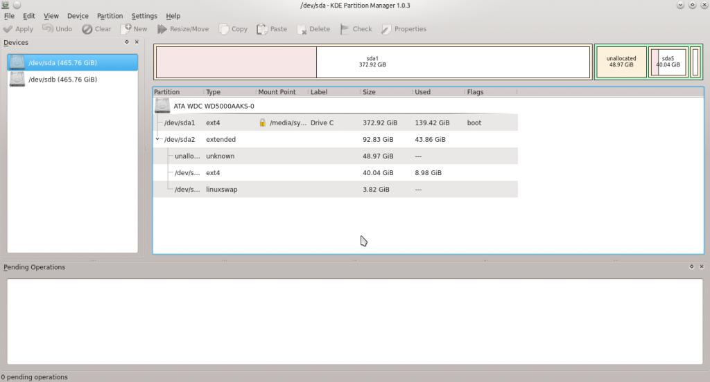

    I have done this before on my laptop now it is not working for me on my desktop PC.
    In this image you can see HDD (dev/sda) and how I have this large unallocated block on dev/sda2. I want to merge it to sda1. Also I should state at this point sda2 is just my Linux OS back up and is not in use I am operating from my other HDD (dev/sdb).

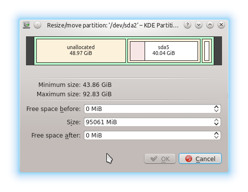

    I start by trying to reduce the size of sda2 to sperate the unallocated block from sda2.

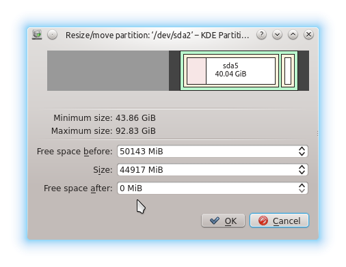

    I attempt to make "free space" before sda2 and after sda1 but the result is an obscure error.

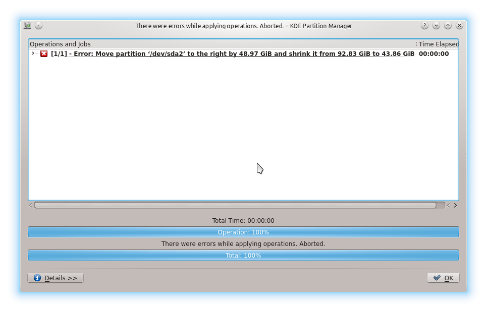

    Move partition ‘/dev/sda2’ to the right by 48.97 GiB and shrink it from 92.83 GiB to 43.86 GiB
    Job: Check file system on partition ‘/dev/sda2’
    Check file system on partition ‘/dev/sda2’: Success
    Job: Set geometry of partition ‘/dev/sda2’: Start sector: 884,779,875, length: 91,988,190
    Could not set geometry for partition ‘/dev/sda2’ while trying to resize/move it.
    Set geometry of partition ‘/dev/sda2’: Start sector: 884,779,875, length: 91,988,190: Error
    Moving extended partition ‘/dev/sda2’ failed.
    Move partition ‘/dev/sda2’ to the right by 48.97 GiB and shrink it from 92.83 GiB to 43.86 GiB: Error

    Just quickly looking at this (just woke up here ... ), IN THEORY, you should just have to 'move the left boundary of the extended partition sda2' to the right by an amount of space equal to that unallocated gap you wish to exclude from the extended partition.
    Nothing wrong, I don't think, with KDE Partition editor. However, my chicken superstition anchors me with GParted (say GParted live CD or live USB, or you can install from Muon and, run it from another Linux OS on a HDD -- as you probably already know). If I were using GParted to do this, I would (in the move/resize window) use the graphical slider thingy to move that left sda2 boundary to the right until it stops where I want it to. At that point, click the go (or apply) button and it should be done. (There's an issue of the entry "free space before" in these panels, and I can't tell exactly what your sequence was (above); but if you actually move that graphical slider (for the left sda2 endpoint), then the proper resulting entries will fall into place correctly at the point that the left sda2 endpoint coincides with the start of the next partition (to the right).)

              I want the "unallocated block" that is currently stuck inside /dev/sda2 to join and become free usable space of /dev/sda1. I would still have sda1 and sda2, but sda1 increased by roughly 48 GB. As you can see this has been on my "to do list" for some time now. No hurry I have plenty of space... I just want my dead space back. The only option on the block is New and I went from Ext1 to swap and everything produces an error.

                You desire moving unallocated space contained within an Extended Partition, into a Primary Partition. You cannot do that, AFAIK.
                  Yes. I think you can do that. That's what I addressed in Post #2. I would use GParted live CD/USB, though, just to eliminate one variable.
                    I mean, it can't hurt! You could try it.
                    You effectively do it by moving an endpoint (of the extended partition).

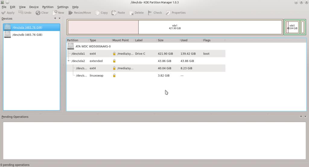

                      I did it guys, thanks to both of you!
                      I realized that Snowhog was saying that I could not mix milk with beer, it just don't work like that. Also I realized that Qqmike was correct in the fact that it could be done, just not with the limits of using KDE Partition Manager. So I booted the Live CD and told it I wanted to install Linux. I told it to use only the unallocated block as primary. Thus pulling off the old turning milk to beer trick! When I rebooted I deleted block using KDE Partition Manager, then expanded the sda1 into that free space. For some reason I lost my boot in the process and had to reinstall it and grub. Other than that, everything went just fine once I knew what was wrong with the method.
