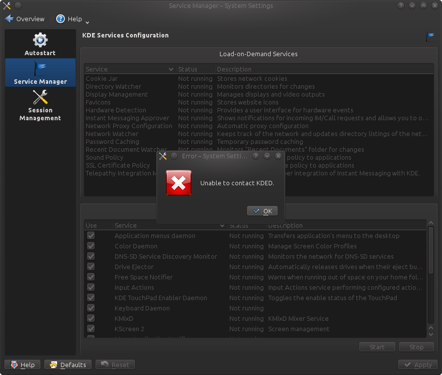

Unable to contact KDED
    Upon trying to access Power Management through System Settings I receive an awesome red box with an X in it and the following: "Power Management configuration module could not be loaded. The Power Management Service appears not to be running. This can be solved by starting or scheduling it inside "Startup and Shutdown"
    When I go to Startup and Shutdown and then Service Manager I get another awesome red box with the X through it and "Unable to contact KDED." Both Load-on-Demand Services and Startup Services are greyed out and all entries display a Status of "Not running".

                    Hi SteveRiley and thanks for your reply.
                    as the OP mentioned:
                    I get the same.
Name:	service manager dialog39.png
