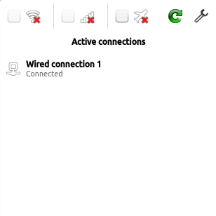

    The network management applet looks like this:

        Argh - it was a broken router port. Funny that dhclient disappears if the cable is disconnected.
        Even the NetworkManager didn't indicate disconnection, but acted as if the wired network was never configured.
