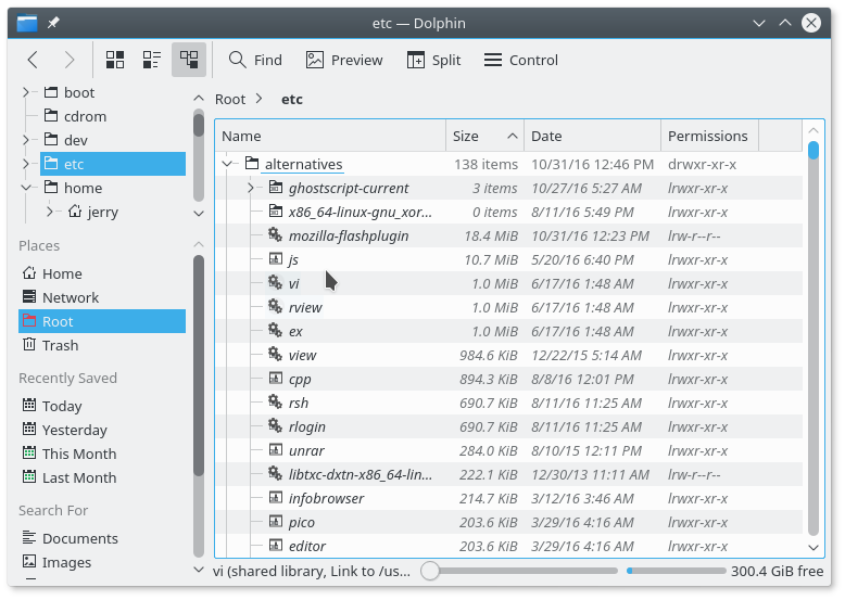

                  It will. You can use Dolphin. Add the "size" column and sort by size. Add the "type" column to know what kind of file it is, and the permissions file to see if it is deletable. That way you can begin with the biggest first!
