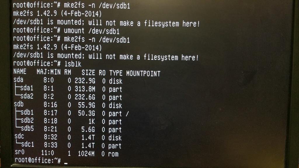

    I have had a problem with my 14.04 hanging on shutdown with a complaint mount: / is busy. This forces me to use the 'big red button' to shut down, which often corrupts the system disk, forcing a safe boot, and run of fsck to get it going again. Except this time, fsck failed. It too got 'stuck'. (This is listed in another post here)
    Trying to use a root console from the safe mode boot is not my forte, but I went there, and tried running fsck on /dev/sdb2, and I get a report of a short read. Using that as a basis for googling, I came across this:
    http://unix.stackexchange.com/questi...open-partition
    The last poster in that thread suggests a bad superblock as the reason why the main portion of the drive appears to be only 1K in size. The drive is a 60 GB OCZ Vertex Plus SSD just over a year old.
    There should be backup superblocks, and I am trying to restore one of them. However, I got stopped early in the above troubleshooting guide trying to determine the block size, as the drive is mounted, and umount does not seem to work. Now, this may be simply because I cannot work on a disk that contains the system while it is running that system. However, I am not sure of that. I know just enough about command line stuff to be dangerous.
    Any suggestions of how to recover this disk?
    I can just reinstall on another disk, or even on this same one, and that may be the easier course. All my data is on the mechanical drive in the machine anyway.
