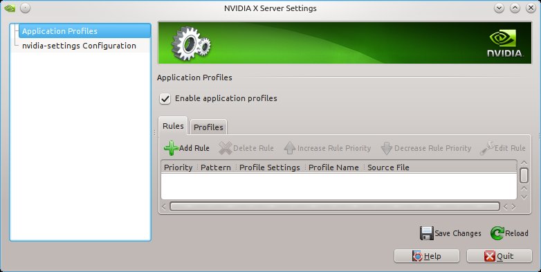

    After installling the nvidia driver (331,38) with the driver manager, I noticed that the characters on my screens had become soft and fuzzy, looking rather like Windows 3! (I am in Trusty.) Going to look at the Nvidia settings, I find only two lines in the interface and no possibility for seeing or setting screen resolution.
    (See attached file. I do not know how to insert it here.)

      Your nvidia driver is not installed, hence the dkms retort "added". This is also why you have no settings available. Nouveau doesn't support that.
