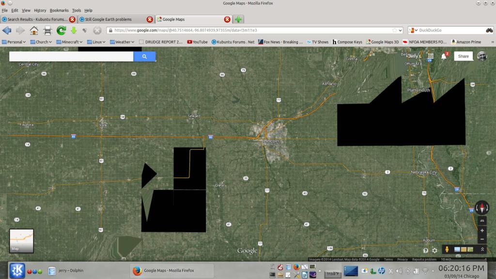

      Below is an example of the glitches the mesa 10.1.0-rc3 package gives.
        I solved my problem. When the mesa 10.1.0-rc1 update (followed by the rc3 update) came down its install process took out the /etc/X11/xorg.conf file I had created which contained:
        Section "Device"
           Identifier  "Intel Graphics"
           Driver      "intel"
           Option      "AccelMethod"  "uxa"
        EndSection
        The "uxa" part replaced the default "sna" installation setting. It turns out that while "sna" makes my video somewhat faster it also makes it slightly unstable. Restoring the "uxa" restored my stability. I am still gettting a vsync'd 60fps in all the 3D graphics apps I am running.
