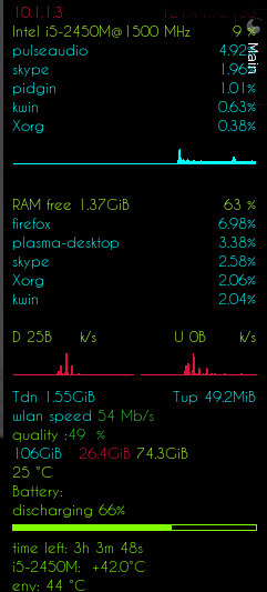

    I think the screenshot describes it better than I can. It appears that Conky is overwriting its panel, but not quite aligning correctly. I know that's not what's really happening, but it's the same result. I've played with different fonts, but no joy. It almost looks like the information is in bold font style instead of regular. Any suggestions? I attached the script too.

      Hi Snowhog. Take a look at the actual RAM usage. You can't make out a number because multiple iterations overwrite the previous numbers. It's like the text is only being written instead of a write text then replace text with the next update. All of the text seems to become bold as more iterations write on top of the previous text. It's frustrating that I can't articulate the problem better than that. The indentation is due to the user (Me) not centering the screenshot utility.

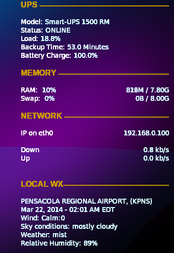

          I ran it here and it looks perfect. Only differences are I had to remove the apcaccess exec's because I don't have one (Cyber Power here!) and I saw an error (launched conky from the terminal) regarding border_margin:
          stuart@office:~$ Conky: /home/stuart/.conkyrc: 38: no such configuration: 'border_margin'
          so I commented out that one line. The other thing I noticed was you have "comicsansms" where as here it's "Comic_Sans_MS" but changing that made no difference - looks OK here either way.

                      Okay, here's the summary:
                      Problem: Multiple conky session were running for some reason.
                      Cause: Unknown
                      Solution: Killing all iterations of conky and then running it from the terminal worked.
                      Misc: I did put Conky in the system settings autostart and not in my personal autostart folder. I don't even know about the latter. The border inner and otter margins are correct, thank you Stuart. And, after several reboots, Conky is running cleanly again.
