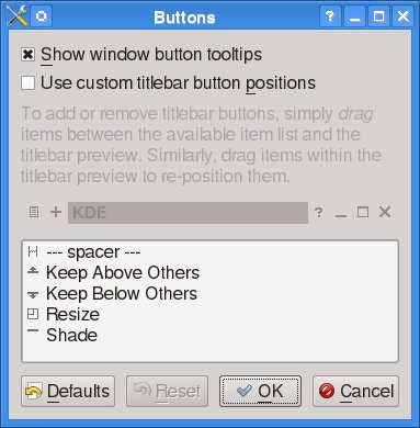

Please go to System Settings | Workspace Appearance | Window Decorations. Click Configure Buttons. Take a screenshot and post it here -- let's have a look.

OK. Next idea.
