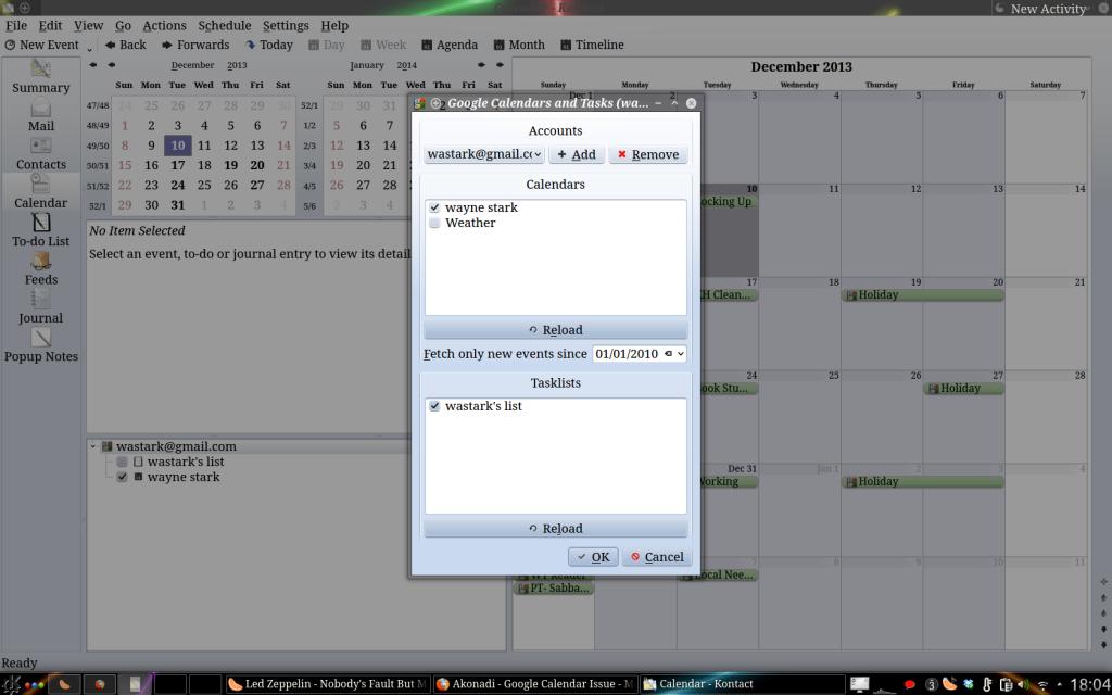

                    Hi Steve,
                    When I click on calendar properties this is what I get:
                      Hm, fewer things to configure than with a CalDAV resource.
                      If you right-click the calendar itself ("wayne stark") rather than the folder whose name is your email address, do you see a fly-out menu with Properties, which then allows you to get to a dialog like this:
                        Yes.. Its set up the same as yours.
                        Do you think changing the "Automatically synchronize after" to say 60 minutes might resolve the issue?
                          In my setup, the 60-minute refresh is configured on the object called RileyZ; the child object Steve Riley calendar inherits the setting from its parent.
                          I think you should change this, but let's look at one more location. If you right-click on the parent object (your email address), can you choose Folder Properties and navigate to the Retrieval tab like this:
                          If so, try changing the value to 120 minutes. Let's see if this reduces the number of times Akonadi uses Google's APIs. I'd also recommend changing this for your contacts, if you're syncing those from Gmail.
                            OK. Most of my retrieval options where set to 10 minutes. I have changed all of them to 30 minutes. If my computer is on all day, by 6pm my Calender will stop syncing. I will see by tomorrow night if changing the syncing interval has solved my problems & post back.
                            Thanks for your help so far.
