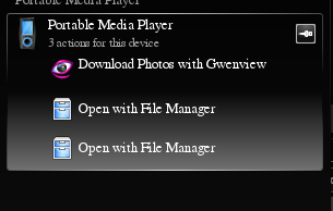

          Oath, that might work... I tried kio-mtp back on precise and quantal, and it always crashed. Just tried it now on raring and presto, it worked. Hard to distinguish between the options:
          The first gives the camera protocol, upload from the phone only, the other uses MTP.
