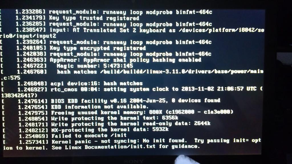

    Then when I boot, I get to the grub menu and select kubuntu and then very quickly, I get an error Kernel Panic and the computer is frozen.
    When I boot with the recovery mode, I get the same error, with some more detail, cf picture.
    But I don't know what to do from here.

          I don't think it has anything to do with wi-fi. Your computer boots fine from the CD, but fails to boot from the hard drive after you've installed Kubuntu onto that drive. We don't have enough information yet to know the actual cause.
          Please boot from the live CD and open a console window. Then run:
          sudo apt-get install efibootmgr
          sudo modprobe -v efivars
          sudo efibootmgr -v
          Let's see the output from that third command. Or, if the second command throws an error, let us know what that error is.

                Have you disabled secure boot? How did you install Kubuntu?

                    I installed Kubuntu with secure boot disabled but with UEFI on. It also seems that Kubuntu is searching for UEFI files but maybe it can't find them because you're on legacy mode. Try enabling UEFI. Besides that I followed the following guide: http://www.slideshare.net/slideshow/embed_code/27418512
                    Unfortunately it didn't work right away, fortunately that solution was simple: running boot repair made everything work!
