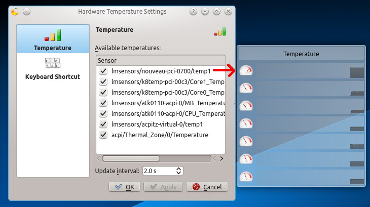

                              The temp widget shows high results: Click image for larger version
