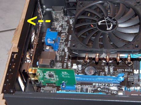

          Mine is a little PCIe plug-in card in a normal (non laptop) PC. The card cost 15€.
          See the green card on the lower left of the picture:
          The hardware is shown in full here.

            Thanks! That does look easy, I think having easy access to the hardware is one of the best things about desktops.
