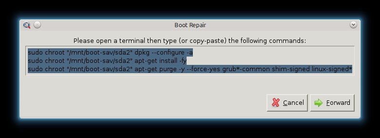

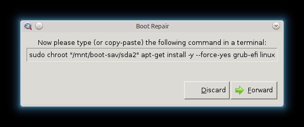

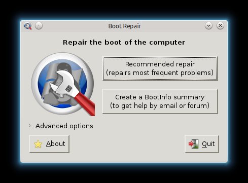

      For Boot-Repair to work it necessary to install files on the installation USB. The instructions on how to do this were previously described by me on this topic.
      Boot-repair will not do anything unless you follow the instructions it gives you. I found these quite clear and easy to follow. Unfortunately, the images to illustrate what to do are not shown in the order in which they were loaded.
      The initial window for boot repair is the bottom one and after you select the top option to use the "Recommended repair", it will then give a window with the text to copy into Konsole. This is shown in the next one up. After copying the highlighted text into Konsole and getting it to complete all the operatons, the forward button is selected to get the next window which is shown in the second graphic from the top. Use ctrl A to select all the text to copy into Konsole. After these operations are complete, and the forward button is selected, boot-repair will do all the necessary Grub changes. When complete the final window, on the top is shown. Here you see that it detected my 256GB SSD disc.
      I have always found that on reboot, I can start Kubuntu on sda as well as choose the recovery mode if needed.
