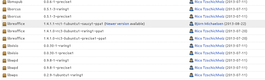

          Just had a look on launchpad and it appears that a pre-release exists for raring is at version 4.1.0 I think you might have the pre-release for saucy that couold be whats giving you the crash/bug

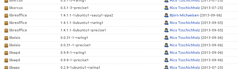

            3. The ppa shows both raring and saucy versions of LO 4.1.1 (https://launchpad.net/~libreoffice/+.../ppa/+packages)
            Curiously, the About dialog in LO says 4.1.2 whereas the ppa says 4.1.1.
            I might see if I can pass this info onto the package maintainer, in case there is an error there causing mine as well??

              I was looking under the libreoffice pre-release not the libreoffice ppa of the launchpad website and it looks like the website hasn't been updated
                Oops. Make it 4.1.1 in both cases.
