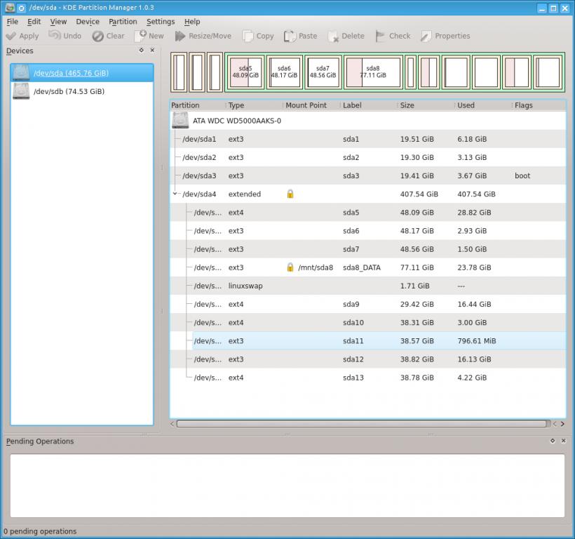

              I have 13 partitions.
              FAQ: How to Partition: http://www.kubuntuforums.net/showthr...on-Regenerated -> http://tldp.org/HOWTO/Partition/

                I thought he had 11 primary partitions which is something you rarely see. I know it can be done with GPT but I've never seen it. On my one VBox .vdi I have 9 distros buy I only consider it to be 3 partitions.

                      Well, I solved my problem by reducing the number of partitions below the threshold. I merged four partitions that I am not currently using into a single partition - seems to make more sense anyway. It doesn't really fix the problem with the installer, but gets me up and running.
