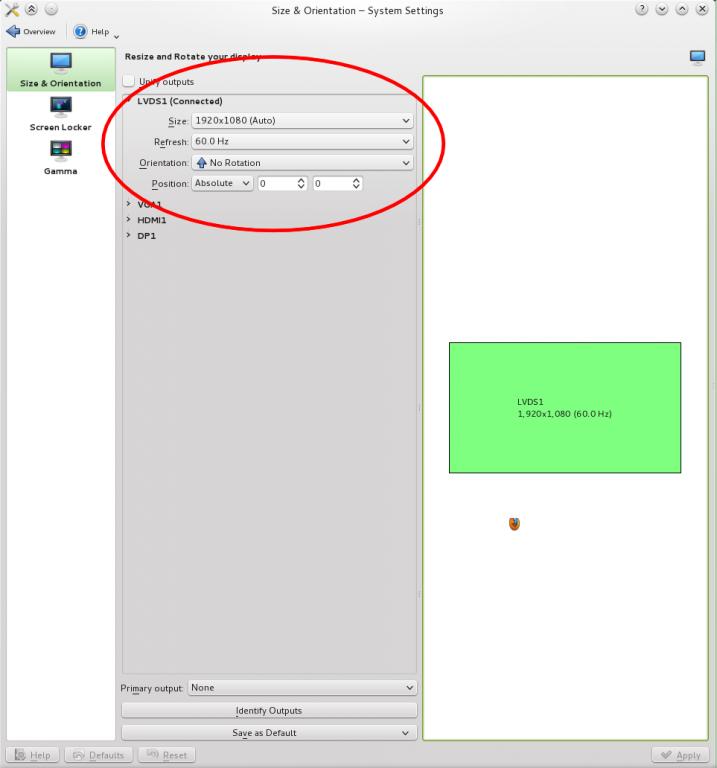

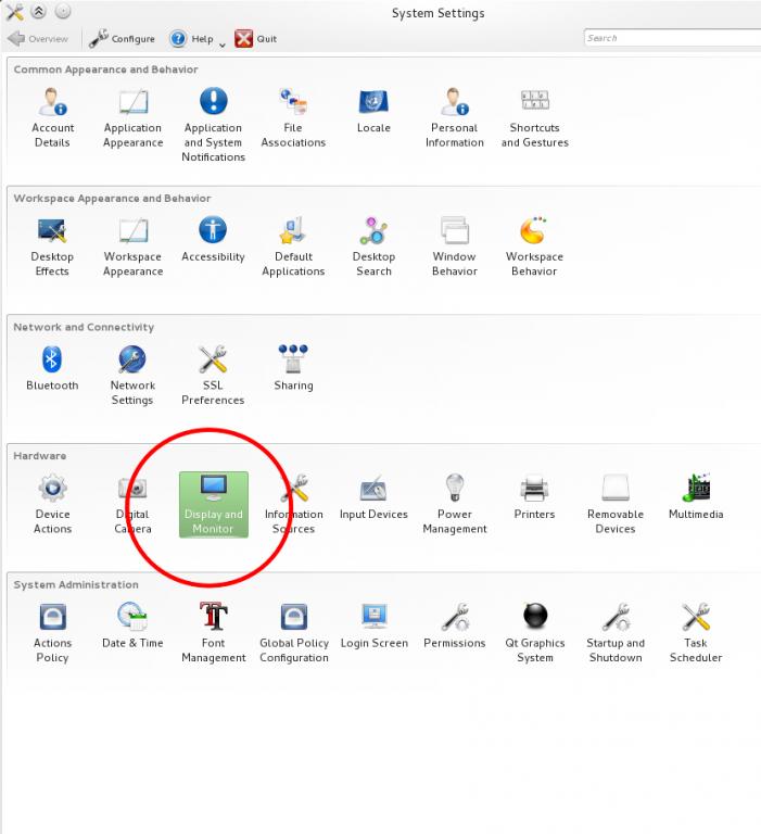

                        Settings > Display > Refresh Rate
                          erm, where is that? cant find that neither in the main menu,
                          system settings or in the nvidia-settings
                            See attached picture steps.
                            then
                              i just dont have that size and orientation thing in your 2nd pic, i have 'display configuration' and 'screen locker'
                              however in 'display configuration' i found something for changing the refresh rate, it was set to 'auto' and i changed it to 60 Hz but it made no difference
