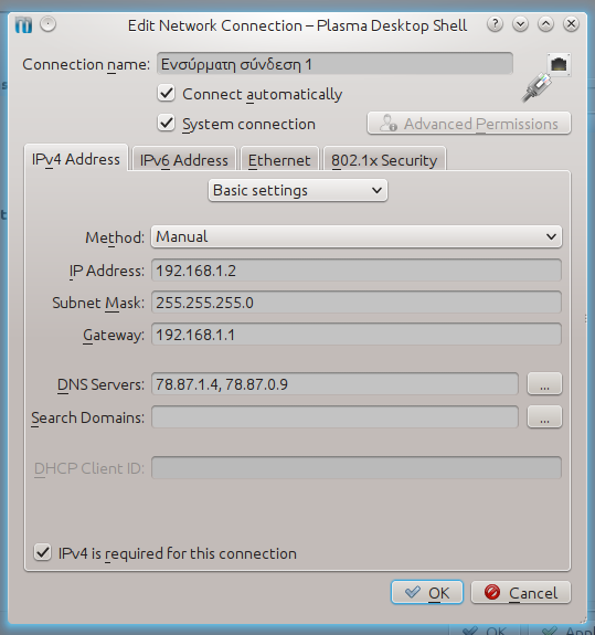

    I tried to setup a static ip, but no luck.
    1) I tried the gui way from kde network manager.
    I set it to manual and I entered IP Adress, Subnet Mask, Gateway and 2 nameservers.
    After restarting the network.......no connectivity.

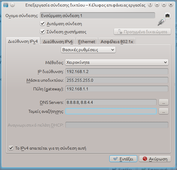

      Here's the corrected settings:
