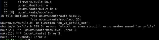

    How does one go about reporting compilation (or any other) error found with a package?
    It's been my experience that if a distro cannot compile a kernel, chances are that no other source-code
    software from elsewhere will compile either. This is why I use a kernel compilation to test the linux
    source code (found in /usr/src/linux-source-3.5.0 in this instance). I do know that simply unchecking the
    aufs module (CONFIG_AUFS_FS in .config) will fix this particular error, but it should be reported to someone...
    Good thing I don't need the following module as well:
      Are you using vanilla kernel source or including ubuntu patchwork?
      On Raring (13.04) the aufs module (and the kernel) builds fine (although I'm using ubuntu 3.8 kernel source).
      The build issue should be fixed by applying a few aufs patches, more information (found through quick web search, didn't check current validity):
      http://lists.debian.org/debian-kernel/2012/01/msg00919.html

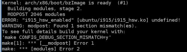

        Meh, the 2nd link works for me. :cool: As for the aufs problem, it don't bother me since I just
        removed it from my kernel config file (along with the listed 2nd problem):
          Probably related to this:
          [ Ubuntu: 3.5.0-21.32 ] * SAUCE: i915_hsw: move i915_hsw_enabled symbol to intel_ips - LP: #1087622
          https://bugs.launchpad.net/ubuntu/+s...s/37/+download
