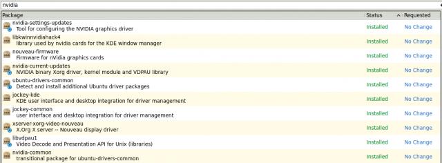

    My computer with a Q6600 quadcore processor, 4GB ram and 2 500GB disks has a nVidia GT8500 graphics card. The processor is not running at 2.4 GHz but at 3 GHz, giving it a 25% boost.
    Still, when watching videos, the image sometimes freezes. I think this might be caused by a faulty graphics driver or wrong setting.
    In the attachment you see what I installed to get the card working. Is there something wrong, missing or installed too much?

    Well, nvidia-settings tells me I use the 304.64 driver. It's not that I don't have a nvidia driver installed, I have so much more installed and I wonder if all that is necessary.
    After a clean install of Kubuntu 12.10, what needs to be done to get the perfect driver setup for my nvidia card, GT8500?
    Do I need extra repositories, what do I need to install and how? Who can help me?
    When you have a working nvidia card plus driver, please show me a picture of Muon showing all the packages which are installed when you filter on nvidia. Have a look at my picture in the original post to see what I mean. I can then see what to uninstall if needed.
    Please help.
      Okay, I just installed the latest through Jockey. I will see what the card does now.
      Thanks for your help, I will report back.
