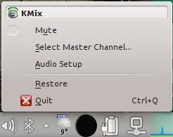

          Klipper will install but wont run. And I just now realized that I'm also missing the small up-arrow information icon! I don't know the proper name for it, so can't try to reinstall.
          I un-installed Muon and tried Synaptic, nothing was gained. So, I reinstall Muon and changed the software source a couple of times and now I don't get the "system maybe broken" error!
          From what you have shown me all I really need is Klipper and volume control working and I'll be almost home. Any ideas on those two?
          Thanks for taking the time vinnywright.fb
            I get the same output as you when I run kmix from the command line. Kmix is not an application that is run from the command line. You should have on your desktop a speaker symbol in the bottom right area as shown in the graphic. If you move your mouse over this symbol you should get the volume setting. By clicking of the speaker you then have the mixer settings displayed. A right mouse click should show the title and the options that are available as shown in the graphic.
            Do you have pulseaudio installed as many applications require it?
            If you have pulseaudio installed but no speaker symbol you may have accidentally removed it. To get it back, try right click and select Unlock Widgets, in an empty area of your desktop,. Then go to the bottom right and right click on the panel toolbox and select Add Panel, then Default Panel. This Default Panel should have the speaker symbol.
            I hope you have success with some of the above.
              NoWorries, thank you! You have help me immensely! More at saving what hair I have left!! Yes, success at last!!!!
              I'm sorry, I had things I had to take care of and could not check back here for new post or any time to follow through for a few days. I did today and thank you again, very much!
              Yes, I have pulseaudio installed. And I created a new panel per your instructions and bam....... behind that new panel was two more! With a little work I'm back in business now with all that was missing and they are working, thanks to you and hanging in there with me!
              and a very, very good day to you mate!fb
                Thanks - Glad it worked for you and that you are not going bald.
