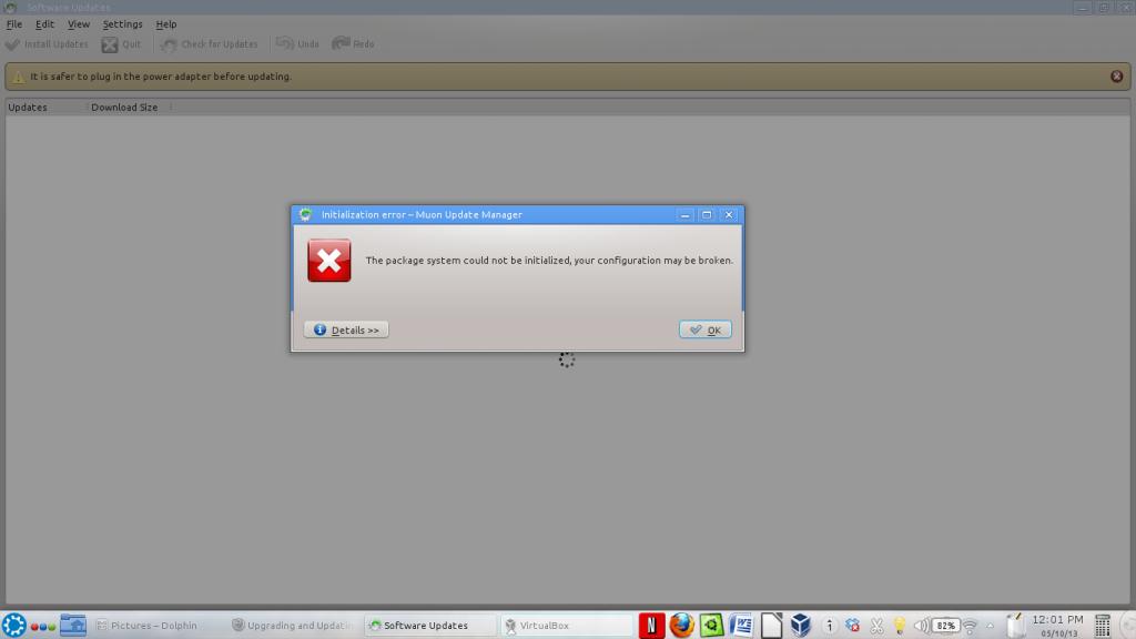

I am unable to upgrade my system due to this message (attached) that I have a Configuration issue with a missing header. Please assist and help me figure this out. Thank you.
Upgrading and Updating Problems!!

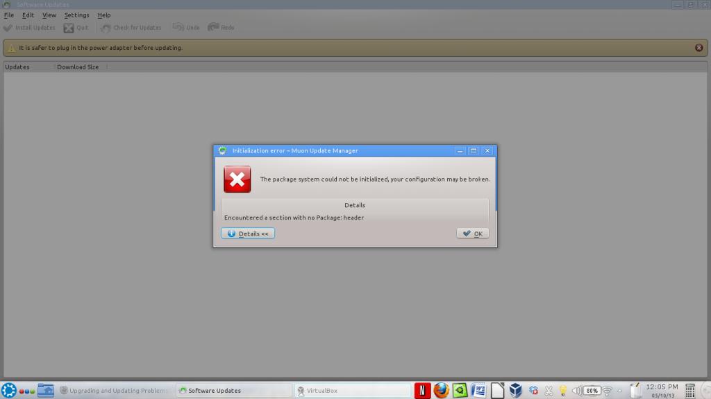

These are the following errors that I get in terminal;
Hit http://archive.ubuntu.com precise-security/main Translation-en
Hit http://archive.ubuntu.com precise-security/multiverse Translation-en
Hit http://archive.ubuntu.com precise-security/restricted Translation-en
Hit http://archive.ubuntu.com precise-security/universe Translation-en
Fetched 3,225 kB in 7s (426 kB/s)
Reading package lists... Error!
W: GPG error: http://archive.ubuntu.com precise Release: The following signatures were invalid: BADSIG 40976EAF437D05B5 Ubuntu Archive Automatic Signing Key <ftpmaster@ubuntu.com>
W: GPG error: http://ppa.launchpad.net precise Release: The following signatures were invalid: BADSIG 497A0F381F691896 Launchpad compholio
W: GPG error: http://ppa.launchpad.net precise Release: The following signatures were invalid: BADSIG 2836CB0A8AC93F7A Launchpad Kubuntu Updates
E: Encountered a section with no Package: header
E: Problem with MergeList /var/lib/apt/lists/archive.ubuntu.com_ubuntu_dists_precise_restricted _binary-amd64_Packages
E: The package lists or status file could not be parsed or opened.

Clean up:
Code:sudo apt-get clean sudo rm -rfv /var/lib/apt/lists/* sudo rm -rfv /var/lib/apt/keyrings/* sudo apt-get install --reinstall ubuntu-keyring ubuntu-extras-keyring sudo apt-key adv --keyserver keyserver.ubuntu.com --recv-keys 40976EAF437D05B5 497A0F381F691896 2836CB0A8AC93F7A
Now try updating your package list and upgrading your software:
Code:sudo apt-get update sudo apt-get dist-upgrade
