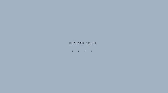

1) Installing the plymouth-theme-solar
![](http://i.imgur.com/pMIhW.png)

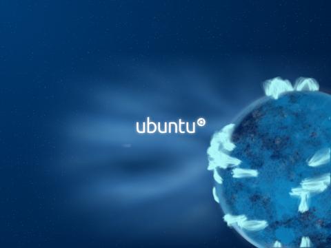

4.1) Test #1
-> Working
![](http://i.imgur.com/LiRo9.jpg)
4.2) Test #2
Reboot
-> There is the plymouth-theme-solar in the shutdown
-> There is the plymouth-theme-solar in the boot
-> Working at here

sudo update-initramfs -u
update-initramfs: Generating /boot/initrd.img-3.2.0-35-generic
sudo plymouthd --debug --tty=`tty` --no-daemon sudo plymouth show-splash
4.2) Test #2
Reboot
-> Working at here
