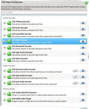

                OK, that answer one question, but k3b will not rip the cd to mp3. Only wav and Ogg-Vorbis for the file type. Missing mp3 option.
                Boot Info Script
                  Review [SOLVED] K3B: How to rip to mp3 versus ogg?
                    Yea, I just found the answer "sudo apt-get install lame" from here http://ubuntuforums.org/showthread.php?t=1649027
