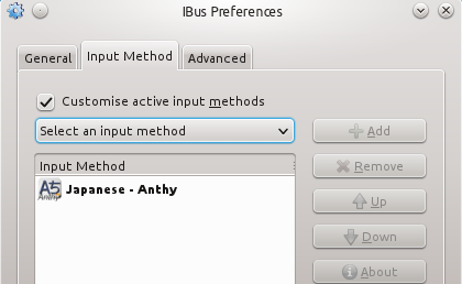

    And this is what you should get once you can add Japanese-Anthy
Name:	capture d'écran3.png
      You should also make sure that in the System Settings > Locale menu, English is set to use ibus.
        Sorry for the delay...
        HOLY SMOKES IT WORKS!!! THANK YOU!!! This must be the obscurest user interface bit I've ever seen! A tiny black > that works... beside a large grey word that doesn't! Dang!

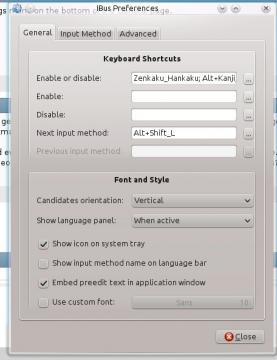

                You can configure the tray icon and language panel from the ibus settings menu on the bottom of the General page.
                  #23
                  No matter how I modify the options on the bottom of the general page I get none of these three things: dropdown menu, tray icon, nor language panel. I even tried changing each item one by one and restarting after each single change, but that didn't help. (Example: uncheckmark "Show icon" then restart then checkmark "Show icon" then restart, etc.)

                    Hmmm....heres how mine is set up. This gives me an icon in the task bar and the language bar when Japanese is active. nothing?
                      #25
                      I tried it that way and I don't get the dropdown nor icon. I'm marking this thread as solved. I can at least type in kanji and presumably if I reinstall the system it would all work now that I know what to do. Thanks everyone.
