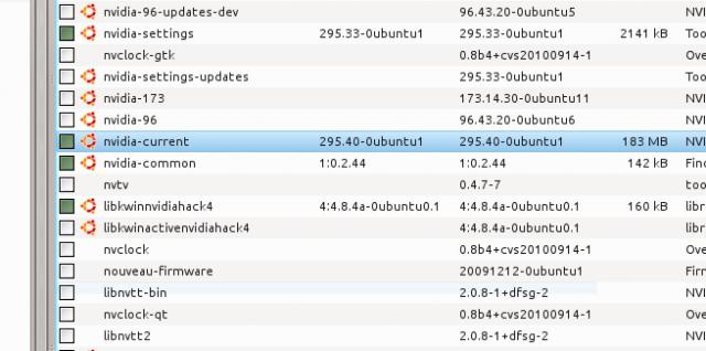

                            Sorry, I just naturally assumed you knew I meant the proprietary nVidia driver. Just how old is the Asus board? You may have to sniff around the nVidia site to see what exactly is supported in their latest stable Linux driver, and you may need to use their 'legacy hardware' driver. This takes some further investigation.
                            Bingo!... http://www.nvidia.com/object/linux-d...59-driver.html This is the 'stable' 64-bit driver, I am not sure what you are using. Click the supported products tab, yours is there (scroll down to GeForce 7 series). Your hardware is also supported in the latest drivers (32 and 64-bit), 302.17.
                            Full 'Unix' drivers (Linux is there also) listings...http://www.nvidia.com/object/unix.html
                            Install Synaptic or use Muon and search 'nvidia'. Click image for larger version
ID:	640020Even when I was forced to download a Linux driver from nVidia's site, they have always worked, sometimes a little tricky to get installed but nothing new there, lol. The driver I am using was in the repository and it works beautifully, actually quite fantastic.
                            If you install it through Synaptic or Muon, the headers, etc are installed for you, a simple reboot should suffice after installation, this is actually a very simple procedure, I find installing anything in Linux much less of a headache then in Win-DOHs.
                            Try this package (kubuntu-low-fat-settings) too afterwards, I found it helped, speeds things up, but it shut just a little too much off for me so I clicked around and turned a few things back on, mostly eye-candy.
