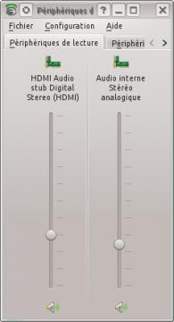

After more investigation, I found out that the keys kind-of-work: they do not control the correct thing. Look at the Kmix image attached: the multimedia keys control the left part, while they should control the right one. How can I change that?
