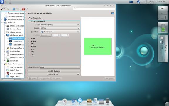

                I'm going to start guessing. Is this perhaps because of an incorrectly set refresh rate? Show us the output of

                  Now somethings got me puzzled, it says "1280x800 (0x49) 69.3MHz +HSync -VSync *current +preferred" which is bull, because my refresh rate is set to 60.
                    You're referring to this:
                            h: width  1280 start 1328 end 1352 total 1416 skew    0 clock   48.9KHz
                            v: height  800 start  803 end  809 total  816           clock   60.0Hz
                    ...and confusing vertical refresh rate (or sync frequency) with the pixel clock. Note that your vertical refresh rate is indeed 60.0 Hz, as confirmed by the third line above. In the first line, 69.3 MHz indicates the pixel clock rate of your graphics hardware, which is a measure of the bandwidth between the graphics chip and the display device. Observe the difference in units
