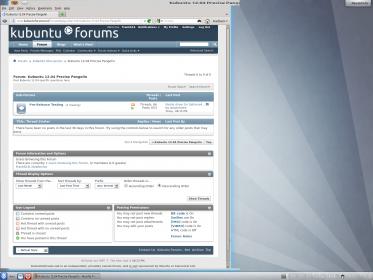

    I have installed Kubuntu 12.04 Beta 1 32 bit on an ancient Dell C840 laptop with the Nvidia GeForce4 440 Go video card. The machine works, but the application windows show the title bar offset to the right of the window, and no min/max/close buttons. The same distro works fine on another desktop machine I have.
    I want to try the Nvidia 96 series driver (which appears to the the one needed for this old card), but it is not offered in the restricted drivers applet.
    How can I install this driver manually?

      Yeah, in all applications. Picture attached.
      Just found out something interesting, however. I exited x and went to the console to try installing the Nvidia driver (which won't install with X running). While at the console, I did 'startx', and, of course, I got the familiar GUI. However, the windows are all correct now. No offsets. I cannot use the desktop cube animation using 'startx' either, though it works (slowly) with the default video driver.
      Any ideas?
      This was posted from the C840 so I could take the screenshot and attach it.

              try changing the window Decorations, (System Settings-> Workspace apperance-> window decorations). i had a similar issue here w/ our geforce 440go. if the decoration does not fix the issue you might also want to try playing with the settings of the desktop effects in the advanced tab.
              (top of thread: thread tools)
                sithlord:
                Well, that did change things, but didn't resolve them. The title bar is still mis-aligned, just differently.
                Anyway, not a big issue at this point. I'll wait for the full version to roll out before I get serious about tracking down the problem. It is an old machine anyway, and it doesn't HAVE to work. I'm not using it for much of anything at the moment anyway (though it pains be to dump it because it is such a well made machine).
