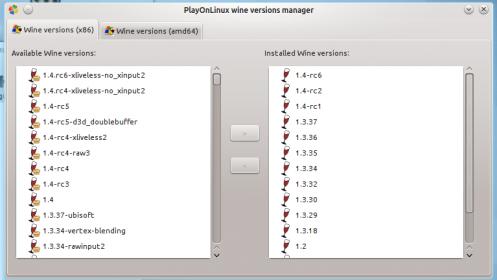

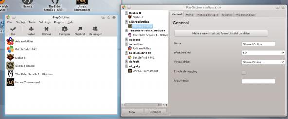

              ..... I totally recommend playonlinux for this. In this frontend for wine you can have many multiple wine versions installed at the same time and set different programs to use different versions of wine. For example, diablo 2 runs best in wine 1.4x while I need wine version 1.2 for silkroad. This covers all that, so you can try different wine versions to find one that works with just a couple clicks.
              Go to the website and get it though, the one in the repo is a bit too dated and feature lacking.
              http://www.playonlinux.com/en/download.html
