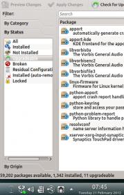

        Teunis thank you for your reply. I was aware that this is the case.
        Or after manually invoking a search for updates in Muon. I just checked, there was one available (GsmartControl) and the notification icon duly popped up.
        This is definitely not the case for me unfortunately.
        As you can see, updates manually invoked in Muon with no update notification icon (Updates1.png). Again some time later, without applying update from updates1.png (Updates2.png).
