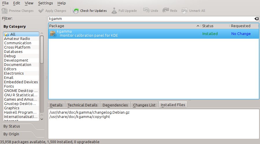

    I installed kgamma to try and adjust my monitor. It installs but doesn't exist. krunner can't find it. I think it may supposed to be a module that shows up in system settings but it is nowhere to be found. Looking in Muon at the installed files section it only lists 2 doc files. Could this be a packaging mistake so that the kubuntu package only contains the doc files and not the actual app?
    I did find one post here that had the same problem in 2008 but there were no replies.

        It doesn't here, see attached pic. I have tried purging and reinstalling but still nothing shows in System Settings.
        Oneline, thanks for that. I should have checked for a bug report. I had a go at following the instructions there but with no experience of making packages I ran into a lot of problems but will have another go later when I have more time.

          There are many repositories&versions available
          Official Ubuntu repositories have the kgamma (4:4.7.1-0ubuntu2) ~ 2.2 kB
          Official Kubuntu Updates PPA have the kgamma (4:4.7.3-0ubuntu0.1~ppa1) ~ 40 kB (bug fixed)
          Changelog
          * Add libxxf86vm-dev to build-deps

            One line, I just downloaded the ppa package and installed it and it works fine now.
